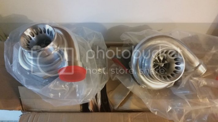

so far, I have purchased a pair of GT30's and all the supporting hardware to fabricate the piping. I will use flipped (facing forward) OEM cast manifolds as they hug the block really well and will leave room for 3"downpipes without having to move too many thing around in the engine bay.

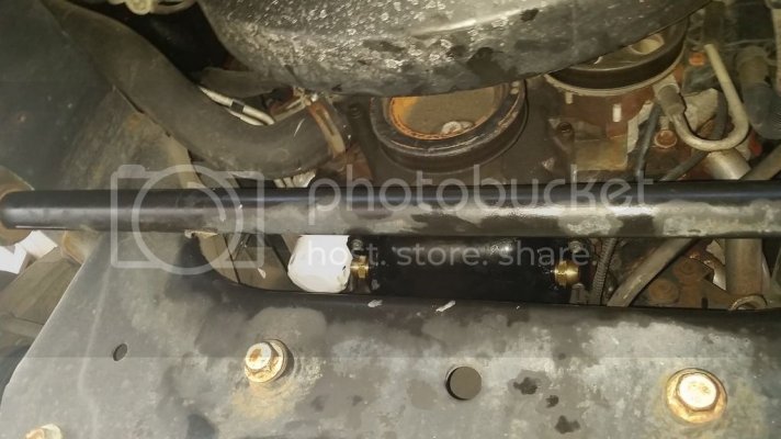

Tomorrow I will start by welding oil return fittings to the oil pan. I will not start on the headers until next week as I have not received the turbo (t3) flanges yet. Any questions or suggestions let me know.

Same here.... you trolled me in then..... BOOM! Pretty turbos!

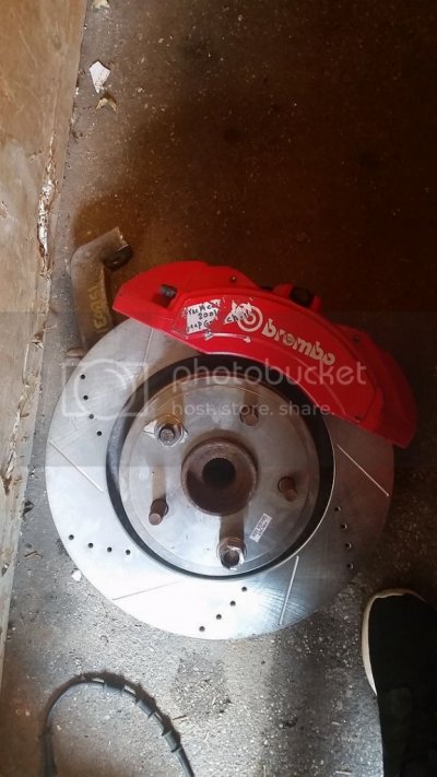

I see a Brembo brake caliper, looks like an LX/GC version. Are you planning on trying to adapt those to your truck, as they aren't a bolt on?

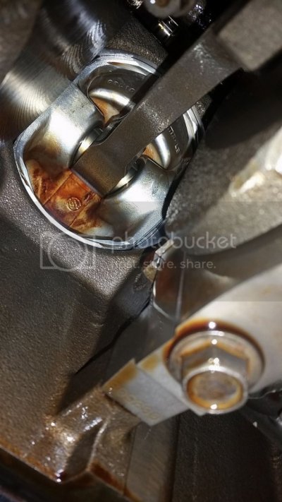

Well, oil pan with welded return line fittings went in today. After removing the oil pan i found a nice surprise. The truck has Mahle pistons i think those are same as the 6.1 srt's as they have the chrysler logo cast onto them, another plus was that the pistons have a thermal coating on them (gold top seen with an inspection camera thru the spark plug hole) so that will probably allow me to run a psi or 2 extra boost!
anyways, header disassembly will start next week.

as for the Brembos, those are JGC and 4x4, Quad Cab spindles. that is another project but it is currently on standby. they are like 60% fitted, but I put it in the back burner for a little bit as I want to do the turbos first while the weather is good

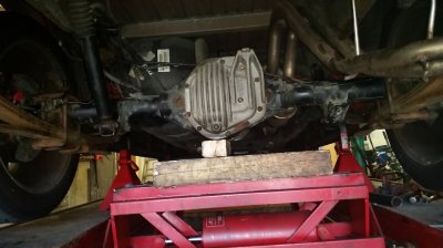

Sorry i had not updated the thread. I have not been able to do anything turbo related as of yet, but i am starting today. The reason i had not done anything was that i came a across a SRT10 rear end decided to install that first.
I am hoping to at least get the exahust manifolds installed today. Wish me luck

@LightningRaper is parting out an SRT10 and he is local to me, I bought the rear from him.
