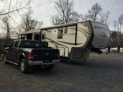

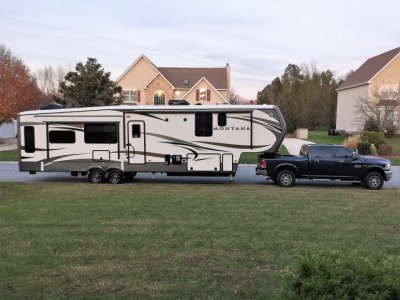

I pull a 13k 40ft 5're.
Truck:
3500 6.4
Shortbed
Cargo-cam
Rear air leveling system
Fifth wheel/gooseneck prep package
4 wheel drive
Anderson Hitch
