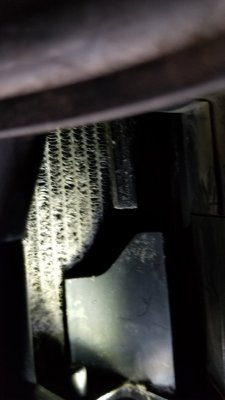

Sounds like My 2012 ram is having the same problem. Started with AC not real cold this fall. Now no heat. I can see front actuator move with heat controler. I took pic of Evap from blower. Has crap in there. I get good air flow just cold. I want to clean both evaporator, heater core and blenddoor but have to remove AC lines to evap. remove dash... remove heater box... just to check them all. Any way to make sure it is not water pump? Truck does not get hot, changed thermostat anyway, rad cap, flushed, cleaned, burped air all twice. Just going to cost to have AC purged and recharged.
