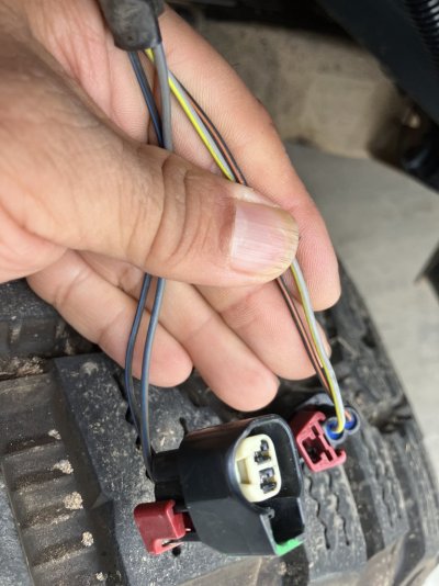

Thanks! I was looking in the wrong place. All the diagrams I googled was showing me driver side next to radiator bracket up front of engine. But I followed the colors you posted and found the grey blue wires up top almost next to the door jamb! I went and got a new dual horn and it works. Thanks again for the quick response
