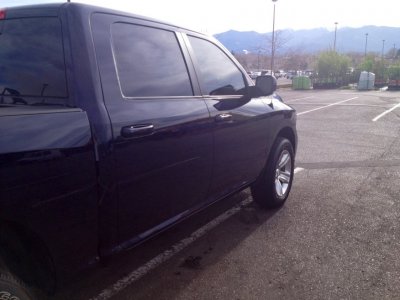

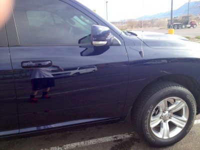

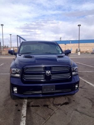

Finally got some time this afternoon to get rid of all the badges and dealer sticker. I just used some fishing line to get them off initially. After that, heated up the 3M and used the pulling method shown on the video here (worked perfect). Finally, heated up what was left, and used Goof Off and wiped away. All in all, took about 2 hours after getting the hang of it. Installing my AFE CAI this week, and then ordering my lift in about a month. She's coming along...:party36:

Nice!! I tried to do mine on Saturday but I don't have a heat gun so the glue was being a ***** and didn't wanna come off so I said screw it and put them back on. I'll give it a shot again when I have access to a heat gun

Awesome

Plasti dip the grill insert and ram heads
so fresh and so clean clean..

Thanks all. I plan on blacking out the front and rear badges. WhiteExpress, if you want them, PM me and we can workout shipping. I didn't have any plans for them anyways. I still need to put a few coats of wax on it and buff it out. When I was washing it, I could still see "ghosts" of the badges. Other than that, it looks 100% better in my oponion.

maybe u could paint the grill and tailgate ramheads the same color as the truck instead of black. That'd look real good. Very nice truck btw.

to the OP. your truck looks great. clean and lean.
