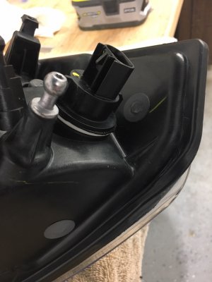

Had the same issue on one on my 2013 2500. Tried all that stuff, didn't help it. I had even extended the vents using rubber vacuum hose. The cause was the rubber seal on on the top adjuster screw. The rubber washer was leaking into the light. I sealed it with some silicone sealer and all has been good. Just wish the water spots were not on the inside.

cwendel, could you post a picture of the rubber seal you sealed? I have a 2015 with a very foggy passenger headlight. I took it apart, dried it thoroughly and pulled the vents out as far as I could. It stayed dry for about a week, now it's soaking wet again...

The rubber seal sits between the housing and the headlight adjuster screw. It is more like a big rubber washer than a seal but that is ram for you. It is hidden while in the truck so I can't get you a picture, but it was the last item I sealed and it stopped the water. I had about an inch of water in the bottom of the housing from it.

If you look at the picture in this post, the item that looks like a gear at the top between the two yellow circles in the adjuster screw. There is a seal between the housing and the screw and this was my leak. And I no longer have the gray caps, just rubber line that points downward.
