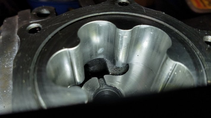

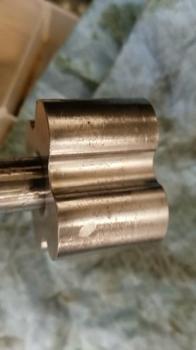

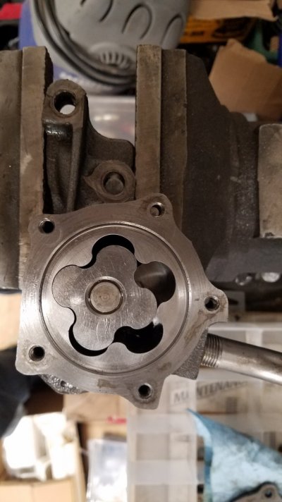

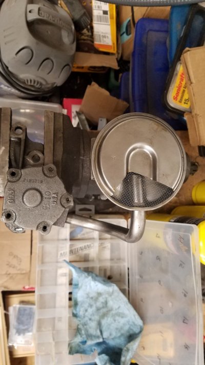

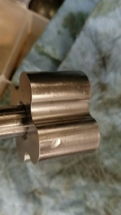

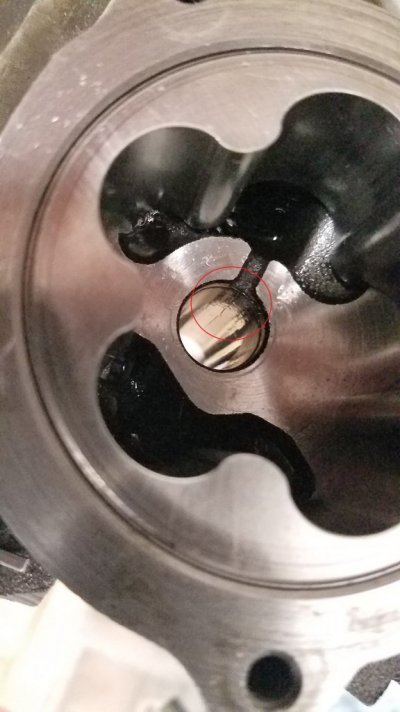

Update:
I may have found the reason why I had no oil pressure. It looks like the oil pump may have been damaged by some FOD although I don't know how it made it past the pickup screen. The pump and pickup were brand new. The damage on the outer pump and pump lobes match up. Whatever got stuck at that point caused damage to all 4 pump lobes in the exact spot. It's hard to see how such a small defect could cause 0 oil pressure but the pump tolerances are very tight. On the other hand, whatever caused that mark could have travelled on up into the engine and gotten stuck in the oil passage going to the oil gauges. I find that more likely since there doesn't seem to be any damage to the engine as far as I can tell. Also, I just noticed something in the last pic. Does that look like a crack in the pump shaft housing (circled in red)?

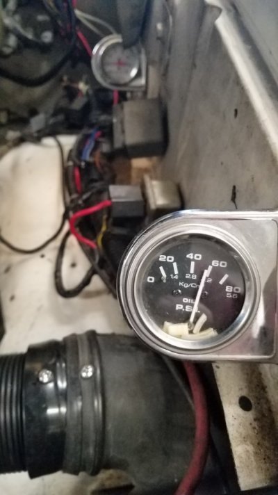

I've replaced the oil pump and rolled in new Main and Rod Bearings. I now have about 60 psi at startup and about 30 psi after warmup.

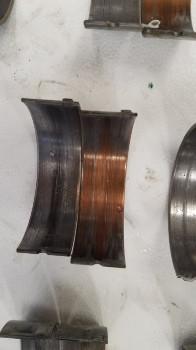

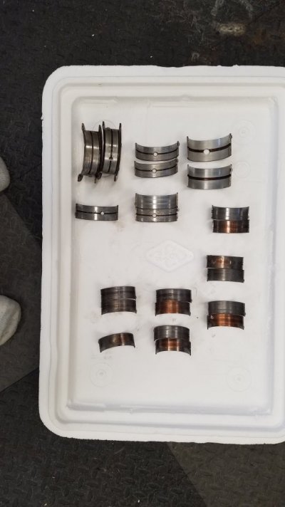

Here are some pictures of the worn bearings. The main bearings aren't too bad but the rod bearings are trashed. It's interesting that only the upper bearing halves had worn through to the copper layer. I guess that's a function of the forces being applied.
I don't believe the wear on the bearings was from the low oil pressure. I believe the original low oil pressure issue was due to the worn bearings.
