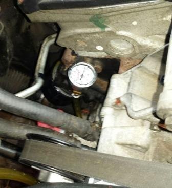

The sensor port is within a couple inches of the pump and should see pressure almost immediately.
I lost oil pressure not long ago and pulled the sensor to see if I had any real pressure and didn't have any. I replaced the oil pump and thoroughly inspected the pickup tube. Installed a o ring and a small mechanical gauge at the sensor port. Fired up and all is good, getting 65psi.
I would first check the sensor.

It's located on the left front of the engine on the passenger side. Look at the picture I posted. The gauge is Tee'd to the sensor.
