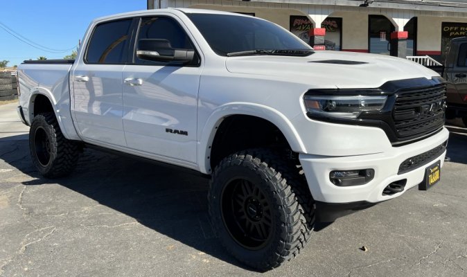

I just had my air suspension removed and went with a 6” Zone lift with Fox 2.5s, 35x12.5x20 Toyo MTs and whatever I could find in an all black wheel. I’m going to pay the dealer $189 to remove the air suspension codes and recalibrate the speedo.
I do have a question around the two fuses to remove though. I read everywhere to remove two fuses - one 20 and one 40 amp. The 20 amp makes sense because in the guide it says air suspension but I don’t see anything related to the air suspension that’s a 40 amp. which 40 do I remove?

@bankr truck looks phenomenal brother
Post a picture of your owners manual fuse page and I’ll tell you what fuse/ relay to pull if needed
Thank you! Although looking at your pic in the other thread and how straight everything is on the truck you did…and then looking at mine, they’re angled down some…it concerns me. should it?
It’s like 4 pages of fuses…but i’ll post it tomorrow to get your thoughts. thanks in advance for the second pair of eyes!
Post pictures of your suspension too. You did the fox 2.5 full length coilover with no spacer on top right?
