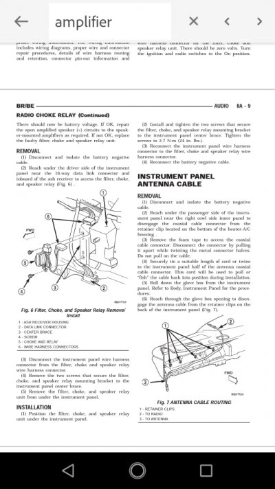

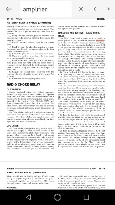

Found this in my 2001 manual. The 2001 wiring diagrams match my 99, so I believe it should cover the 2000 also. c53906bf1bfa6661d2b9c7d2344459e3.jpgc09c776108fd9ff4b97a8414ada03fcb.jpg

Thanks verry much Bear. I'l see what I can do.
