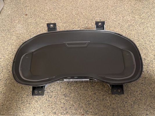

Just so we’re talking about the same cluster, is it this one with the fully digital display screen:

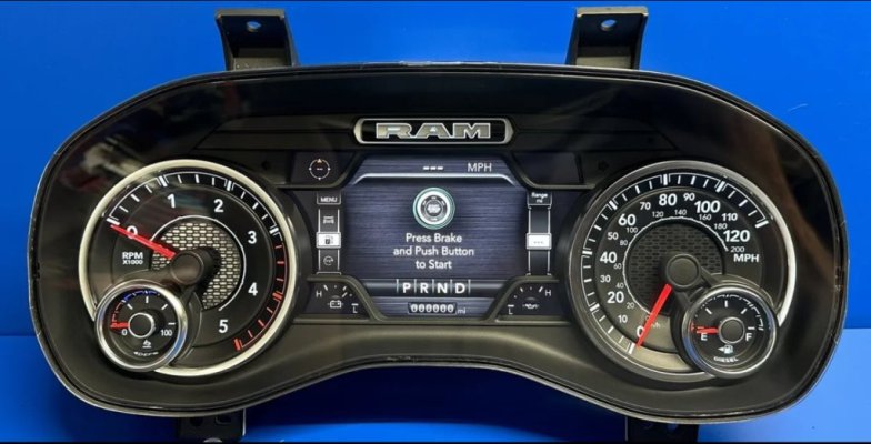

Or is it this one with the digital display in the middle, and physical analog gauges on each side:

Ah! It is the fully digital one, no physical analog gauges
Jimmy07
Feb 23, 2017
3,520
3,584
Ok, for some reason, that cluster does not populate the tire pressure screen when the body control module is configured for TPIS and 3500 SRW.
The only known way to get the tire pressure screen to populate on your truck is to use alfaobd and configure it for TPMS instead of TPIS.
