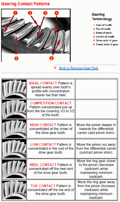

Coast noise is most likely back lash on the extreme side of tolerance or bad tooth contact. I have done a lot of redoes from other shops over the years and found the gear contact is the biggest problem. The guys are paid flat rate and want it out in that time or less. As picky as I was on making the tooth contact perfect on both drive side and coast side, a full day of set up was not uncommon especially with aftermarket gears.attachment.gif

^^^^^ This is some great information!!!!! This doesn't mean you're going to be an expert after you read it but it sure is a great foundation!!!!!!! IMHO
Thanks, and welcome to ram forum. Real informative.

Haven't seen the chart SnapperJP posted in decades.
Taking the time to do it right is a lost art.
