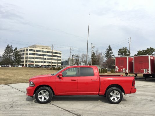

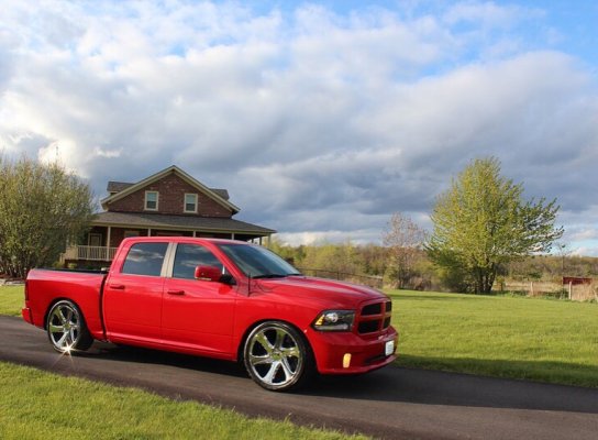

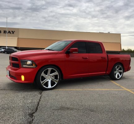

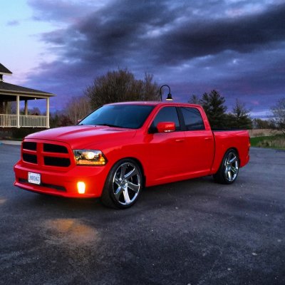

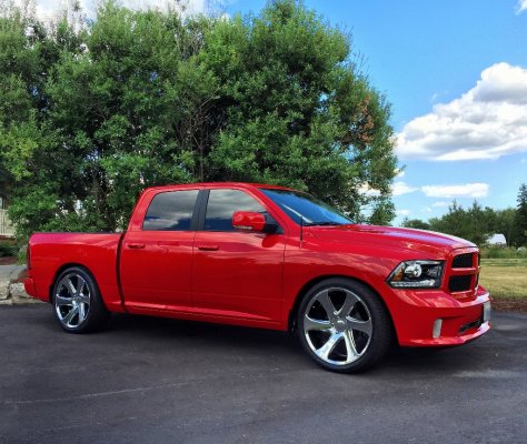

Here are some pictures of my ram at different heights. At max air it goes back to stock height in front and 1" higher in rear. Full air out, obviously not driveable. The rams suspension and geometery from the get go is terrible. There is ZERO good option for properly lowering the rams in the rear unless you relink the entire rear setup IMO. Even running the INEZ etc kit, it requires cut coil springs to achieve a bigger drop. relink and coilovers is really the best bet.
The air, for daily driving, is the best bolt on alternative, but is also very costly in comparison with coupled with a good air mkanagment lift 3p or Accuair.

This is my standard ride height. 305/35r24
No air
salazarn54
May 9, 2017
51
34
No air
Full air
