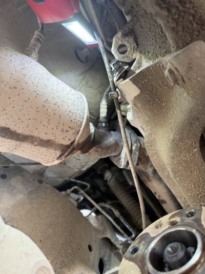

I started stripping one of my o2 sensors trying to get it out with an o2 socket. I cut the exhaust line and disconnected the cats at the manifold to drop the whole assembly on the floor and used my 1/2 inch impact to break it free. No amount of heat, penetrating oil, air hammering, breaker bar extension was going to get it.IMG_0969.jpeg

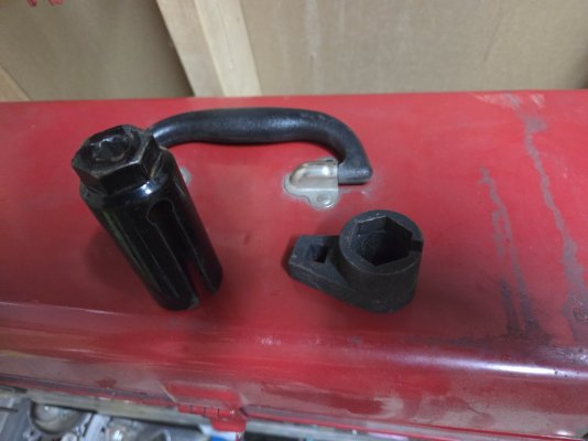

These are the two I have, the one on the left is great for when I have room, the one on the right for when I don't
In this case, I could slide the right one on, grab a 6 or 9 inch extension and put my breaker bar below it
I have those exact same two sockets. The little one I have put an large holed washers on to keep it from expanding and slipping.
Plus penetratung oil the night before. Heat on the Buung and welding gloves to keep from frying my fingers the day of.
