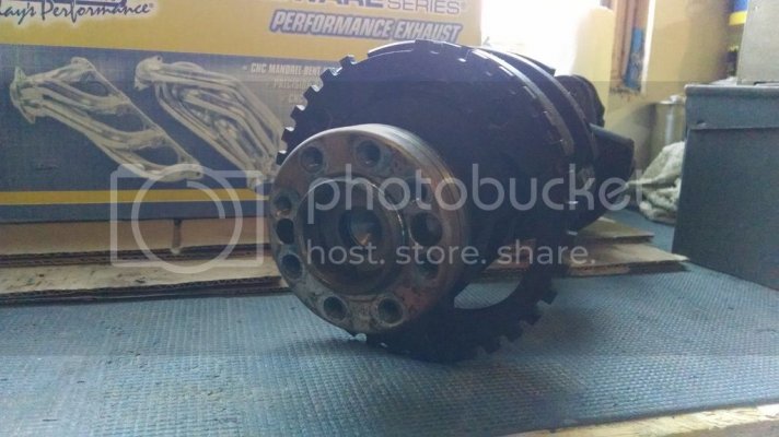

In case you don't have your old engine for reference this is what it looks like with the bushing removed.
IMG_20140218_075739712_zpsfwanzsgo.jpg"]IMG_20140218_075739712_zpsfwanzsgo.jpg[/URL]
