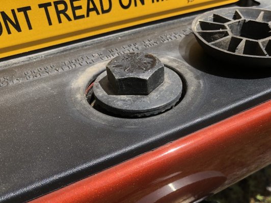

Yes, it looks like this one with the cover on it.
Pretty sure that's a class III hitch.
Someone correct me if I am wrong but the class IV hitch that comes from that factory doesn't use a bolt in that location. At least mine doesn't.
I believe the one Neil E & I have is Mopars class III dealer installed option:
Rating is 12,000-lb tow rating, 1,200-lb tongue weight rating with weight distributing equipment; otherwise 5,000-lb. tow rating, 500-lb tongue weight rating.
The Factory installed class IV option is:
I haven’t found the ratings on the factory option but believe its 14k tow with distribution and 10k straight tow.
I’m thinking of removing the bumper bolt so I can install the flush mount plug. I don’t really tow and as long as I remember to reinstall the bolt if I do tow (don’t even own a trailer) then it should be fine.

Okay so you both do have a class III. OP said they installed a class IV.. sorry I get stuck on the little things.
That explains why it was half the cost of a factory trailer package.

Funny, when I got rearended - they replaced my factory hitch and when I got the truck back - it had a new hitch with this bolt through the rear bumper too.. kind of was like what is this?? I hate that bolt and cap/cover on the step bumper.

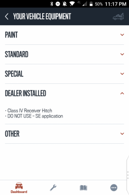

Just to add confusion, I just looked at the app on my phone, and Class IV shows up as dealer installed, not a class iii
Only way to verify would be to get the part number of the hitch they installed and google it or something to see if it is actually a class III or not. What you've got pictured is an example of complacency. They invoiced a class IV hitch and then said they installed a class IV hitch. I'm calling it complacency because I don't think it's a class IV but as I've said before I could be wrong.

Class 3 hitches are typically rated around 8k so what you have is a class 3/4 with a standard hitch it's a class 3 rated for 5k lbs 500 hitch weight when you add a weight distrabution hitch it increases your rating to 12k 1200lb hitch weight. So you have both. Its plenty sufficient for a 1500.

Well, pretty much all the Rams have the hole in bumper with the cover on it. Yes thats not a class IV with. However one thing you missing and would make a class IV cheaper at the dealer etc, is that most factory installed class IV's include towing hook up for lights etc.
