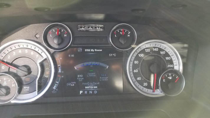

Awhile back (like 150,000km ago) I replaced my boring base SXT gauge cluster with the upgraded LCD cluster out of my friend's totalled Power Wagon. Everything works great, except my odometer read what his was last at when I installed it and is now consequently 26,000km short of what it really is.
While it's not a big deal and I just remember to add 26k when I'm checking if I'm due for maintenance, I'm wondering if there's a way to fix this?
My truck is a 2015 1500, truck it came out of was a 2014 2500.93c318d7fa65e9ea051083e081d8112a.jpg
