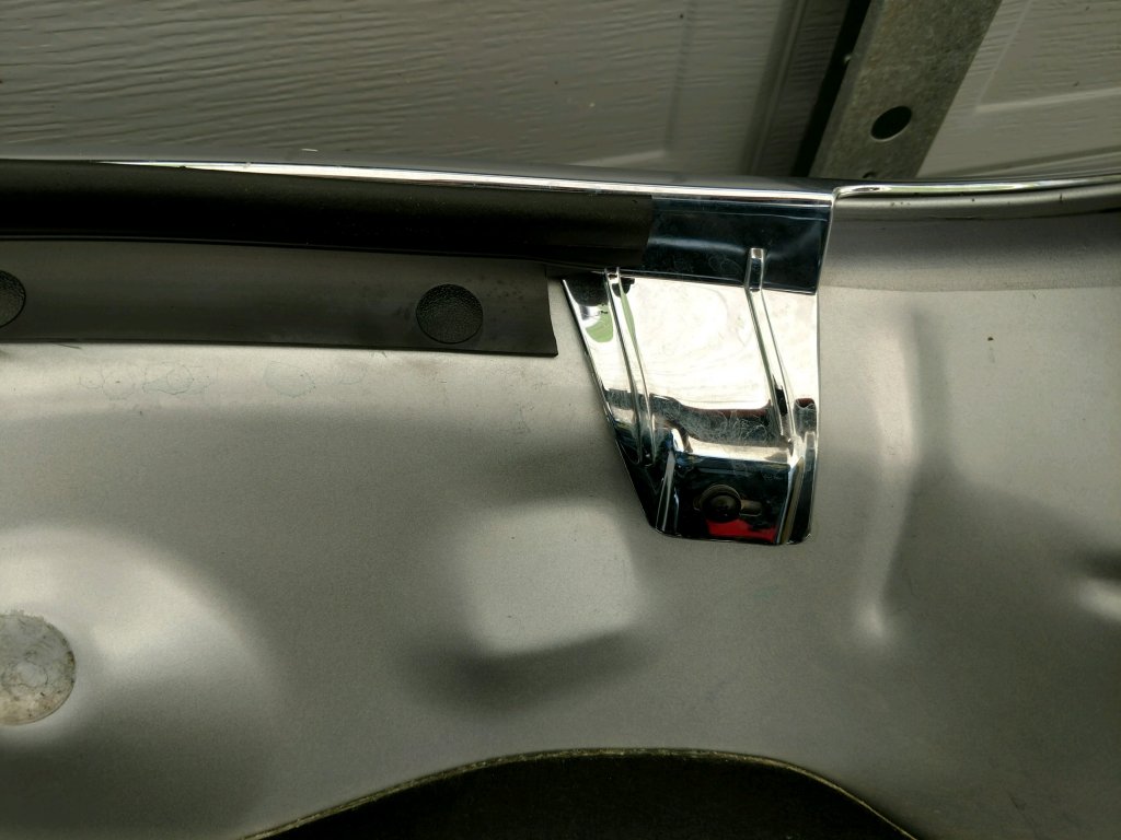

I have the chrome OEM deflector and no the rubber didn't need to be removed. The instruction did require the ends of the rubber strip be trimmed but not remove the entire strip. Will get pictures if you want.

The OEM deflector uses holes already in the hood. Kit comes with bolts and retainer clips. I assume the smoked and chrome install the same.

The deflector is all once piece. It uses 4 mounting points, two of which you can see in pics 1 and 2. There are 4 holes already in the hood and the deflector came with plastic retainers to put into those holes. Then you line up the deflector and screw it down to the retainers using the bolts in the kit.
Only thing to trim is the rubber piece. That's about it.
