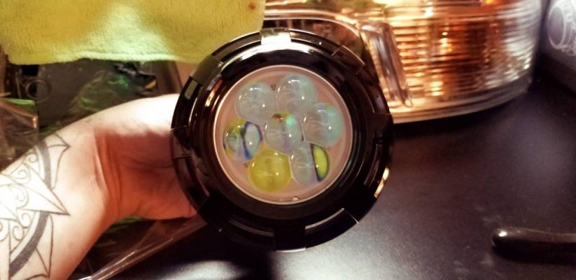

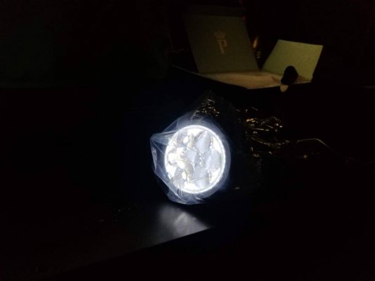

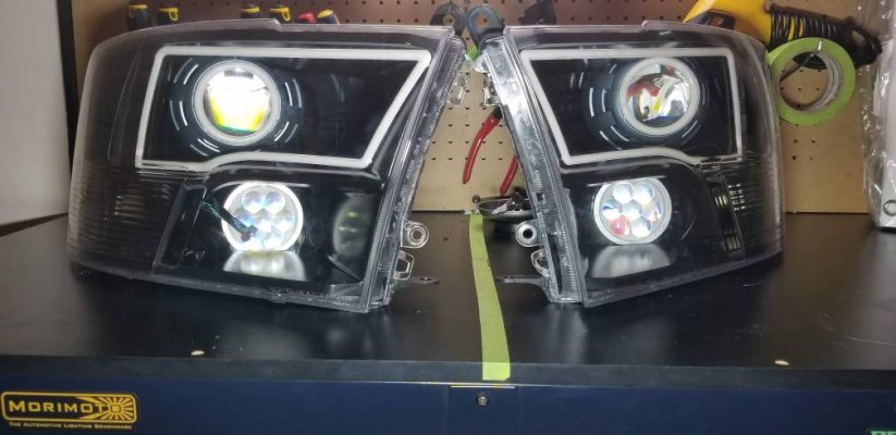

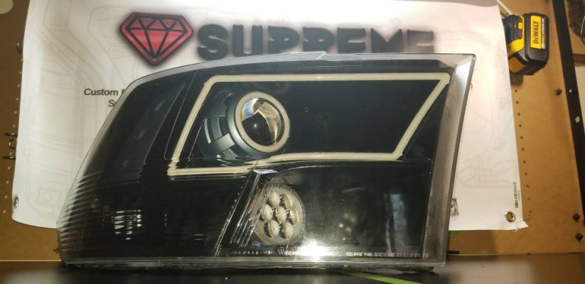

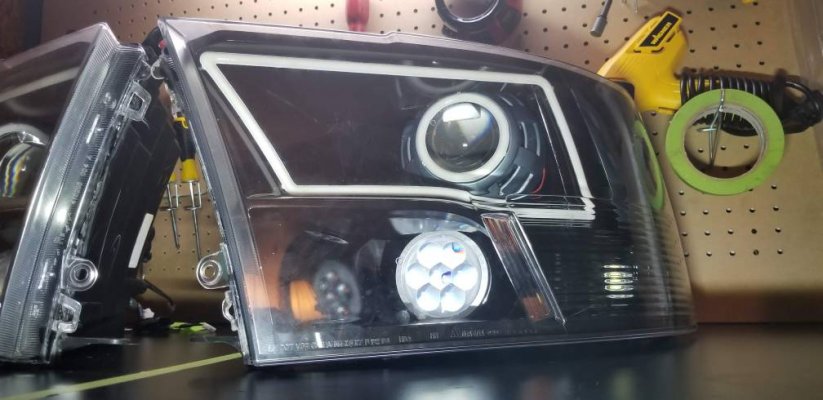

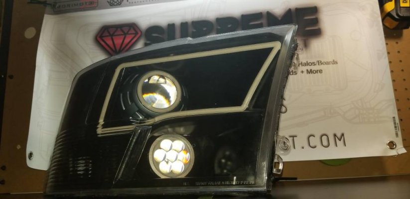

I just recently retrofitted a pair of 09+ OEM Quads with 4 LED Morimoto Projectors. They are by far the brightest retrofits I've ever seen personally, hid included, and for the price it cost to do all of it, it would have cost the same to do a Mini D2s retrofit and some led cube or LED bulb or something in the high beam.
The low beam is the Morimoto M-LED Projector and the high beam is the Profile HiLens LED Projector which was designed to be specifically for High Beams.
*** Ignore the fingerprints and dirty lenses, this was before I cleaned them up and resealed them***
197058318c7ea9c9dfc3a654b3027cca.jpg4eceb33df22b1463cc807786dd5c369e.jpg1f0389d2ff1035988c97e6a31bed21bd.jpga46a77bb0c3c140c1e6d59ea5601edb9.jpgf64b0805ae0dc4a0a713a5673908f191.jpg
The color temp, instant on, light depth, width, etc is near perfect. I never get flashed or highbeamed and they look amazing! Don't be so quick to judge aftermarket LED Projectors. I can't vouch for any of the afternarket Osram, Koito, Profile, iLed, LightWerkz or eBay/Amazon Generic LED Projectors because I've never personally used them, but the M-LED and the Profile HiLens are the real deal and the best part is everything fits inside the housing, so from the outside it looks like the normal headlight with just the normal H13 plug that goes to your truck, nothing extra. Nice and clean retrofit.

I think your talking about a plug-n-play LED bulb kit, while Spud2388 is talking about a full LED powered Projector found on some of the new higher trim level 2019 Rams.

You won't fit a full size 3" or even a 2.5" projector in the high beam area of the OEM Projectors. It just won't happen. It's hard enough to fit a 3" led cube, and the 3" projectors have the shroud on top of the 3" projectors so they really are around 3.75".
Either way, you said the PJX projector were made by Profile? I don't see them listed as being made by Profile anywhere. LightWerkz Instagram has posted about them a few times and nowhere did it say they are made by Profile. Also, apparently according to LightWerkz there is a M-LED V2.0 coming out sometime in the future.
As for the Profile BiLens being better than the M-LED, that's not true. I've personally seen both in person, and the M-LED is way better in almost every aspect.

And the Profile HiLens that I have in my High Beam spot, it's not "small projectors" in there, it's one projector, with the lens having the multi-lens effect which alters how the light is spread. It's the same as any other projector, just a different lens.
You can't even see the "multi lens" once it's turned on unless you look from a hard side angle which won't happen if it's in a headlight.
Also, the HiLens can have any of the Morimoto Shrouds mounted on them, they just clip right on like any other 3" projector.
They also for PERFECTLY into the OEM Quad high beam spot. No need to Dremel out the bulb hole, no need to cut or trim any of the housing internals, it just bolts right up with the mounting shaft, and that's it. Best part is there are no driver's, no ballasts and it has a 9006 plug which plugs right into the stock high beam plug and there is no need for any harness or adapters as the 09-14 Rams don't have Canbus on the high beams. It's truly plug and play, zero modifications needed and it's only $80. Same price or cheaper then decent led bulbs or a led Cub pod. And it's output is amazing.

I'm just saying, the profile HiLens fit into the high beam spot, with very very little room above and below it and it comes in at 78mm in height. Any full size shroud averages 127mm-135mm in height. Almost double the size of the HiLens. I have a Dremel, I build a set of lights almost every day and I'm constantly using my Dremel on quads to fit full size shrouds, so I'm very familiar with the quad headlights and their sizing. If you cut up a 3" shroud (which is all of them except the "mini" ones) you will have to cut off about 50% of the shroud, losing most of it in the process. That, or you will have to cut the entire plastic housing that separates the low and high beam areas in the quads.
Either way, good luck with whatever you decide to do. Post pictures because I want to see what the outcome is when you Dremel your lights to fit any projector in the quads high beams other than the MatchBox or HiLens. Definitely want to see how you do it and the outcome. Keep us updated.

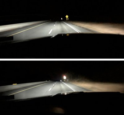

I finally got out tonight and took some photos. This is on my 19 with the LED package.
This Photo is of the truck stopped. The top picture is Low Beams, the bottom, High Beams.
This Photo is the truck moving on a highway. A little blurry but I think you'll get the point. The top picture is Low Beams, the bottom, High Beams.
Really appreciate it man. Definitely helped clear some stuff up. If you think about it and you’re ever facing a blank wall, snap a picture. Would love to see the cutoff and where the hotspot is. Thanks again.
Also, how do they operate? Are both on for low beams and both activated for highs or is one for low and one for high on each side?
