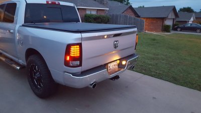

The harness is perfect to add the LED upgrade...did on my 2015.

they're so much brighter than the incandescent lights. and they look waaaay better.
i have LED in my reverse lights (really i have LEDs everywhere) and the taillights look so good. brightened up the rear view cam at night too
