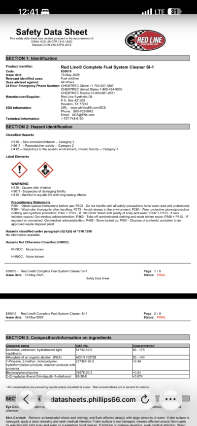

I believe redline S1 is more potent by using 1 or 2 bottles per tank. Some people online is using 1/3 of a bottle per tank but it doesn’t do much in term of clean carbon buildup.
FYI: see photos

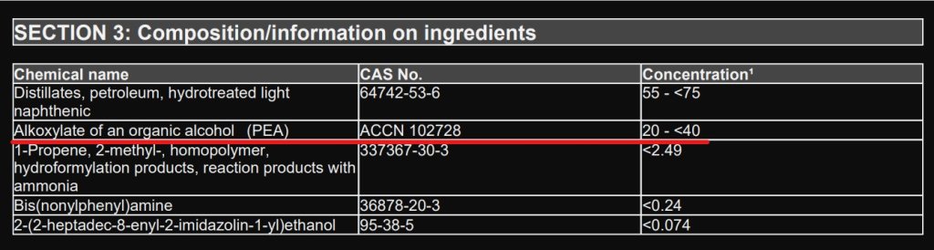

I wish that I could still see tiny characters like that, but those days are long gone. :cool:
What is the definition of the expression 20 - <40?
https://safetydatasheets.phillips66.com/Webviewer/DirectSearchResult/Result?product-id=830019#
Amsoil's pi SDS is 25<50 Alcohols, C12-15 Propoxylated, Aminated which is PEA.
Amsoil PI is 12th ounce bottle and Redline is 16 ounces bottle. We don't really know what the carrier oils are and how they effect PEA on the surface, obviously as tested with 5 out of 5 boroscopes the redline will melt old carbon. I can assume Amsoil pi would be similar, but no data compared to what we know si-1. Anyone wanting to hunt pi data feel free to post it. I don't care about brand, just what gives us results. Pricing very similar between both around 15 bucks, since redline is on open market sometimes less sometimes more.

Math, assume lowest SDS stated quantity.
5% 20 ounce = 1 ounce pea RP max clean
20% 15 ounces = 3 ounce PEA si-1
25% 12 ounces = 3 ounce PEA pi
Assume max treat rate
15% 20 ounce = 3 ounce PEA RP max clean
40% x 15 ounces = 6 ounces PEA si-1
50% x 12 = 6 ounces PEA pi
So if redline and amsoil pi add minimum % and RP adds maximum, RP would have same PEA treat rate. As you see on paper Amsoil pi = redline si-1 on reported range of PEA. My guess at a minimum redline adds close to the max, its the only thing that makes sense due to results.
