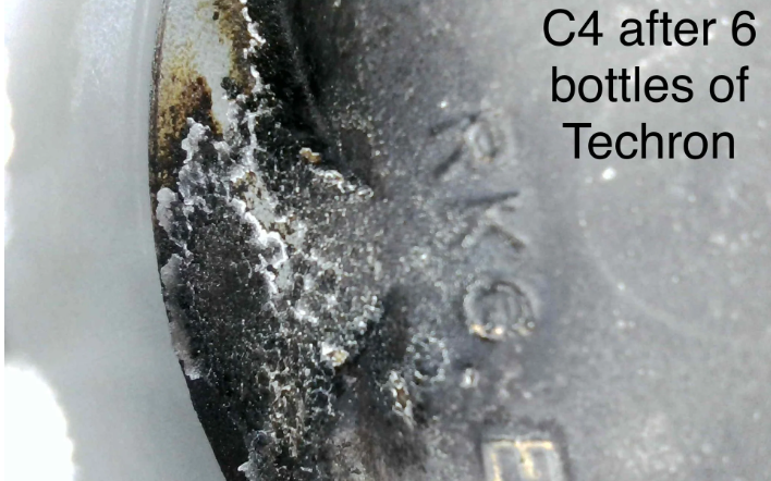

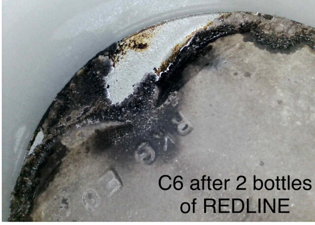

OK sorry forum but I do not believe Corey aka hemi395 or I had ever brought a si-1 thread here. We did do one at bobs, just never officially did a thread here on it. We were going to wait until we did more tests and never got around to it, but thanks to another fellas work on the net I think the results of this product as a combustion chamber cleaner are second to nothing known, so I will post some boro's on it past and present. For even more boroscopes see BITOG, yet another fella there also posted very similar results. So I am fairly sure at this point the stuff just plain works, and as of yet we know of nothing else that does with the exception of similar results by chris fixes sea foam through vac lines tube. But, at this point I'm not even sure if that works as good as si-1.
Corey's before and after boroscopes first, then I will post some pics from another website. Some really good new info has to do with dosage, the other fella did a more extensive test and found when he was adding full bottles it would melt away carbon, but doing it every tank with a smaller dose there were no gains, but also no loses as in carbon wasnt growing back. What to do with that info is personal choice. I personally do full bottles before oil changes, and I think I will stick with that unless when I boro my chamber something changes my mind.
Corey's before and after, and his before was after he had tried some other additives, I forget which ones but clearly they didnt do much. His after was after si-1. You can see other guy labeled his cylinder and noted additive use. Even with 1/2 case of techron you see some cleaning, but with 2 bottles of redline you see the carbon more like melting off the cylinder. I cant link his thread here, but google it. His photo's werent tm'd so I post them for your consideration unless he complains later. This is also similar to the other guy at bobs who video'd all his cylinder, I will see about posting those as well.
hemi 395 before pic-
hemi395 after pic redline si-1
jimhow4545 from mdxers
So this should stand as the official si-1 thread, so please post experiences good or bad in the thread, this is the place for it.

The best part of this is that recent test was si-1 against techron with proof. Kinda why I posted it now. We (me, kyle and corey) wanted more confirmation before moving forward, well that was amazing imo.
So I like the idea of a full bottle before each oil change. Maybe 2 bottles in some cases with older cars like over 100k miles.
I believe top tier gas still leaves carbon in rings, there just isnt enough detergents. Even techron which is the official detergent of chevron isnt enough with 6 bottles. So this is a weird statement, but redline si-1 might literally be a needed product for good rings at about every 5k mile, maybe 10k. Even all of chris fixes tests showed nothing this good. I tried to get him to try si-1, he is taking it under consideration. No reason to go back to bobs, everything is posted here, many different examples all show the same thing. It works where it is needed the most, sides of piston tops.
