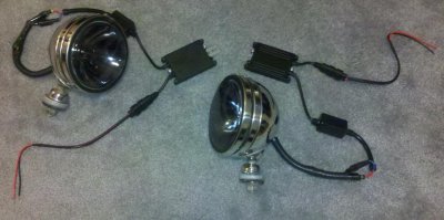

I just finished converting my old 130W KC Daylighters behind the grill in HIDs. I used H3 55W 5K kit. Disassemble the light housings, gorilla glued the bulbs in along with the metal clips and put back together. The rest is just splicing wires. I also laminxed them and plastidipped my grill inserts. Night pics to come!
