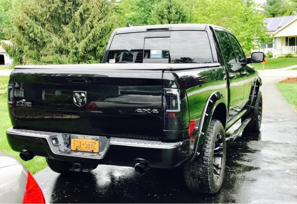

Hey guys, I've picked my wheel and tire combo. 20' fuel beast with 33' ko2's but im not sure which offset to go with. I want them level, with if not past the fender flares. Would a -18 suffice? Any help would be great.

I ran -12 with some wider fender flares and it kept them just inside the fender flare, keeping rocks off the side of the truck. -18 would probably be safe, and if you ever choose to lift, it would also keep them from rubbing on the aftermarket knuckles that come with those kits. I would go with -18 all day, and wish i did -18 instead of -12 for that reason. -12 leaves about half an inch between my 12.5 wide tires and the aftermarket knuckles.
What a coincidence ;-) I have a -18 offset with fuel vapors and 33” tires. 94ae3e859ae7e9086453c333f2286dbc.jpg
here’s a pic. Love em! Almost wished I went with a -24 to bring it out just a tad more. I have the RSST from ready lift. eafae4dde45846b8e6aae3cd736954cd.jpg
