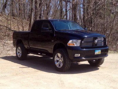

What gear ratio you got? I've got an rcx 6" lift with 35's. Lift is great. I installed it myself in a day and have had no issues. I've got 3.55 gears and I want to go with 37's so bad but there is no way I will until I change my gears. The 35's took away some bottom power end and it wants to downshift more goin up hills.
Stock gearing, really not sure. Do you have some pics of your setup?

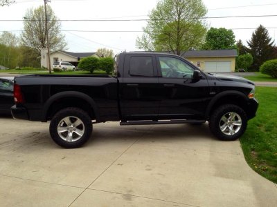

I have 37" mud Grapplers on a 22" wheel. 3.55 gears. Just wait. It's sweet and fun, but man do I miss the power. Plus the 22" wheel/tire combo is HEAVY. Makes it feel like you are pulling a trailer honeslty, especially when braking. If I could do it again id go for a 20" or maybe 18" wheel. A tad lighter. How much does re-gearing cost anyway?
