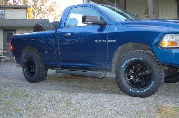

Since you have 18's you can keep OEM still looks good imo. Here's the best tire poll. Here's my tires just to show same size more aggressive look with at tread. If you go bigger you lose much comfort and zippiness for better off road characteristics. If you don't go offroad, you already have good sidewall compared to 20s. These are 18's with OEM size at tread.

Those are nice! Definitely something like that. New rims necessary?

Those are rebel knock offs, I had twenties moved down to 18's for the sidewall. Ebay is a great resource for rebel knock offs cheap, other guys can find you the best deal, they are inexpensive. Wheels and tires less the 2k for me.
If you like rebel knock offs the bonus is OEM offset, means perfect filament.

maybe your right 17's, even better. I know you cant go as low as 16 w/o serious work, so if you get rims make sure 17's. Verify for 5 gen, this info is on 4 gens. The do look better in person as well, I have plenty comments mostly pumping gas. Something about bfg's.

no I forgot my are also 17's, brain fart if I am lucky, brain tumor if I'm not.
bottom line more sidewall gives you the big tire look whether or not you have big tires. So imo 17's are the way to go as you can see.
OEM 20 versus 17's, I hate the photo but just for the big tire look same exact size. Wish they were cleaner to really guage, but who is going to clean throw away.
