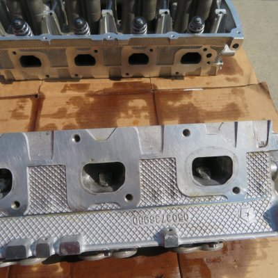

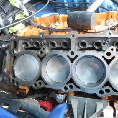

At the very least this is all interesting stuff.
Then there's the old school trick of spraying water into the intake when the engines hot and running at roughly 2500 rpm.
The best cleaner is to pull the heads and manually clean the pistons and combustion chambers :waytogo: :Big Laugh:
With a bit of work you can install a catch can , aka air/oil seperator on a 6.4,but it's a bit more difficult then it is to install on a 5.7.
