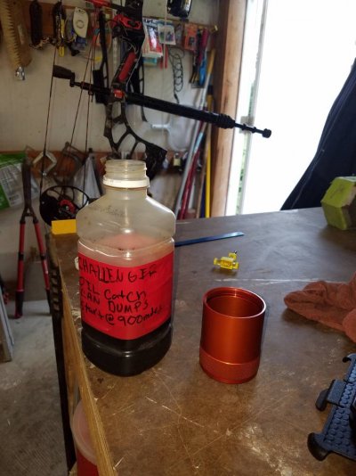

Go with Billet Technology. It’s more expensive and the sweet finishes are even more + the wait, but it’s definitely worth it and their customer service is awesome! They have pretty decent sales during the big holidays.
Burnt Orange I purchased over the July 4th holiday:

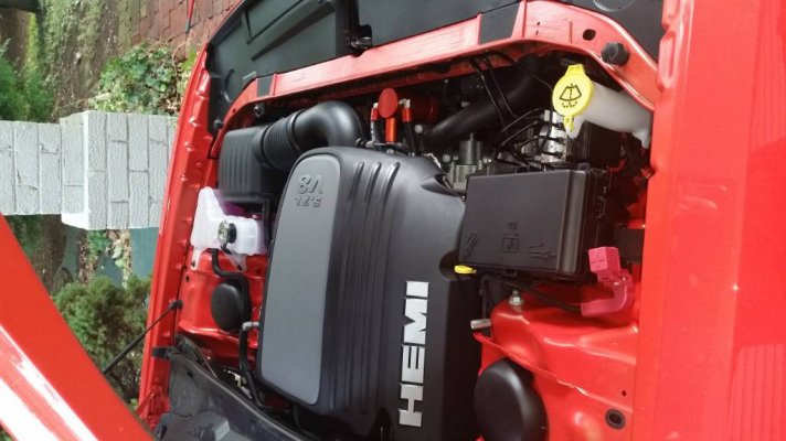

Nice , I put the BT burnt orange one on the wife's Challenger [emoji106]6d2f781a5b950a3a65d3ce5f3ce39624.jpgc469bebc2fe8f37ef4258b13ef0e7ef5.jpgb3e3537cca35f9b516558968936a373b.jpg66918eec962c62b2dcbca04ba7a16a16.jpg
