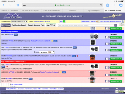

Really dumb question folks, but is the oil filter part# the same on the 6.4's from previous years? I am (was) just about to drop the break in oil on my 2020, but I can't see the part # on the filter to make sure before I do. I have a few of the Fram XG10060 left from my 2015- that's the same as the 2019, so I can only assume the 2020 would be identical. Can't seem to find the answer- or I'm just dumb.

I went to the parts counter because I was having trouble finding the part number earlier on, Mopar had changed the part number but the item was no different at all. Just as long as it is
4892339AB or AA. Either way I think it says MO-339 on it. At least that is what the parts guy told me...

I use the basic wix 57060. 12 pack through rockauto is $5.69/each.
I got these Fram Ultra on sale in the city so I grabbed a bunch- worked out to $7.50 Canuckabucks each. Have 2 left over that I will use up, but our little mom and pop parts store gets the Wix XP which I hear are just as good so I will get them next. I usually order all my oil and filters at once in the spring for the machinery- so he has them on the list too. He also gets me the PUP 0W-40 for cheaper than I get at the dealership in the city (even with my discount). Gotta support the little guys!
