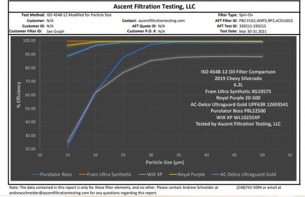

Not if this is correct... In fact oddly wix xp is the only filter to not level out with efficiency even with large particles. Do some research guys. We all want to know which ones are good, follow the science.

1 micron to um = 1 um
So you can substitute micron when you see um, since most of us understand Microns. For every 10 particles 50 microns size, wix xp lets one though, and it is the only filter tested to do that.
Good grief...wix starts off crummy and only gets worse. Glad I'm stocked up with RP filters!

The other "Real" question is how xp performs throughout an interval as opposed to cellulose filters. Because paper filter simply loose their filtering ability with heat cycles, and likely are in bypass the entire time. I would love to see if someone tests used filters this way compared to spun microglass. But I see no reason to use wix xp unless you prefer to have sand size particles running around your engine. Enough teasers, read the oil filter thread for more info guys, many guys contributed over there for years.
Occasionally BITOG comes though, now we all see why they hate wix xp so much. Not that they "like" RP, but at least they acknowledged the weaknesses of wix xp.

Glad I still pop into these threads from time to time. While I normally use RP and never really see Wix around here I would've still been under the impression it was one of the better filters
