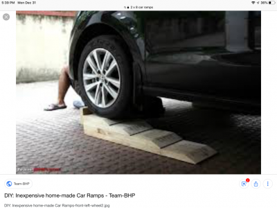

I use my 3 ton floor jack and lift from the front cross member to get about 3-4” extra or so, then jack stands under the frame behind the front tires. There’s 3 points if contact without having to drive up on to ramps. But to each their own, and very interesting idea on the DIY ramps.
You got pics of them?
Similar to these. Im at the beach for NYE, so no first hand pics...Mine are 48” long and 4 levels, slanted edges. The boards are glued and screwed. If you can crush these, youd be the first! I store them vertical bottom to bottom on a homemade skateboard.
