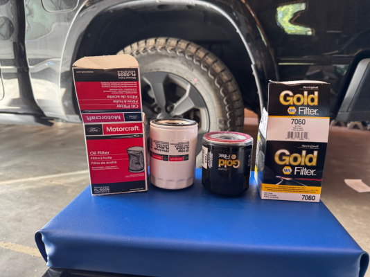

My 2014 3.5L EcoBoost uses a larger filter, but not by a lot.
Edit: Added pic.
