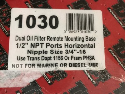

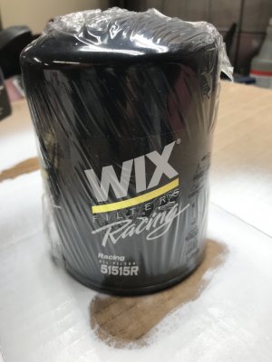

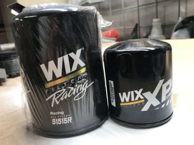

Not on a 2500 but I use a Trans Dapt dual filter kit and Wix 51515R Filter. The kit part number is 1213 (the 1030 is JUST the base)
Between the two filters I get an extra quart of oil capacity plus it runs slightly cooler.IMG-0570.JPG
EDIT: Stock size filter and 51515R size comparison.
Between the two filters I get an extra quart of oil capacity plus it runs slightly cooler.View attachment 228095
Excellent, I'm gonna check that out and compare it to the thread pitch and all if the 6.4 thank you very much.
Running cooler and extra quart of oil is a good thing

That looks pretty clean. Curious did you have issues with your single filter set up or did you just want better filtration? I do tow but not often but I do like the idea of the better system. Especially since I plan to keep this truck a long time. Thank you for the pics. I was wondering if there was room for the dual filter setup now I know lol

More like i kicked my ass for not going to the dual set-up right from word go,must'a had a blond moment when i bought the original set-up,as my experience with dual filters goes back to the early 80's,and i knew the pressure would come up with dual filters.This pic is from the early 80's on my old 68Z,just after an all night thrash to replace the BB i'd blew up at about midnight the night before.Had a professional photographer coming to take pics of the car at 11:00 the next day,and the deal was he'd do the pics free,but he wanted a ride in the car,so me and a buddy thrashed all night to swap out a blown up radical high dollar 427 for a running 454,that's why the motor isn't colour matched to the car,and not all the hose coverings were all on.That 454 for being out of a 1 Ton was actually one of the best motors i ever had in the car,it swallowed nitrous better then most engines i had in the car,lol.But you can see the dual filter set-up on it,and it's the same TransDapt dual mount you buy to this day,lol

Caution before you buy! 5.7 Hemis use a 3/4 x 16 thread size and 6.4s use a 22mm x 1.5 thread. I work for Napa and we carry an ATP 18428 remote filter kit. I will check tomorrow if it will support the smaller 6.4 filter size.
Anyone note: The Wix 51515R filter is a RACING filter and IS NOT DESIGNED FOR EXTENDED HIGHWAY USE!
