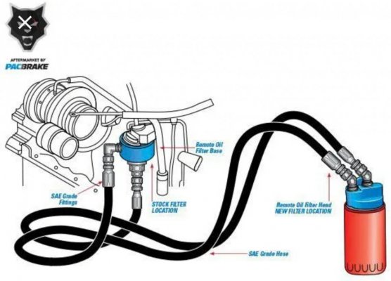

Good morning, I own a 2016 RAM 2500 6.7 Cummins diesel. The oil filter is in a particular place that makes it easy yet difficult to change. I’m looking for a good filter relocation kit. Can anyone recommend a quality kit?

Is this installation very difficult ? There seems to be very little room at the top to ( wrench ) the fittings .
Getting the air cleaner/intake system out of the way frees up room. Maybe try searching youtube for an install video.

Found it through google video search. It was the first one to pop up. The company themselves have a channel. Here you go.

Thank you . My Ram is a hemi , not a Cummins. Is there a big difference ?
No the gas ones that have done this or even went to a double filter set have seen no difference in oil psi.
