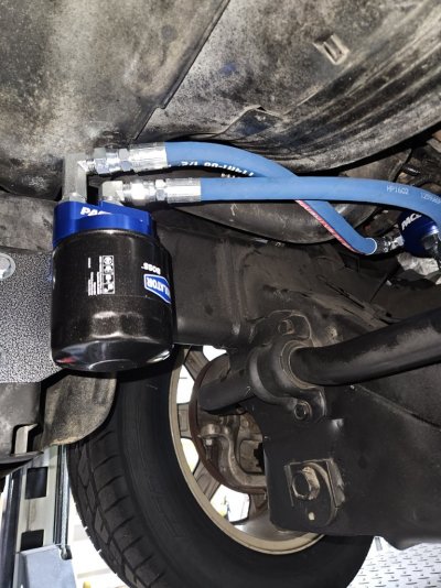

Remote mount attaches to a bracket the bolts to the odd "post" on the front of the frame. Mounting this took some trickery, I used tape to secure a nut to a wrench then fished it inside the box from the bottom opening and top opening.
The sandwich plate and fittings took some effort to install, but not the worst job ever. I was lucky to have a large 1-1/4" wrench to tighten down the plate very well. I suppose a good adjustable wrench would work too.
Hoses went right on, they are heavy duty and stiff so it took some wrangling.
Attaching to the remote mount was easy also, simple connection, just tighten some fittings.
Whole process start to finish took me maybe 1.5 hours.
All completed I am extremely happy with this kit. The stock type oil filter screws on easily and it is still up and out of reach, anything will hit the frame box before hitting the oil filter, but is still in a great spot where I wont have to jack up the truck to change my oil anymore. For that reason alone it is completely worth the cost to me.

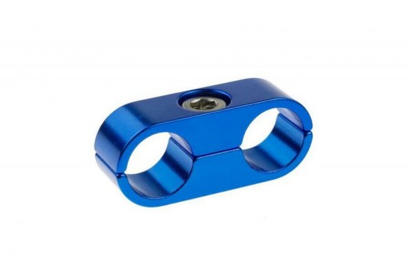

Now just put one of these on your hoses:
Blue of course.. I just did the same thing with my filter relocation, but used a different product. Also put the Furmoco on at the same time. Changing oil should now be a pleasant experience... Nice job..
Where did you get that?
