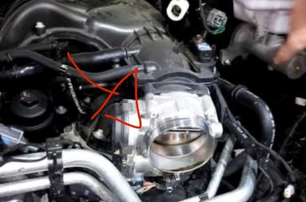

This isn’t my photo but the oil puddle is here in the throttle body, when I took the air intake resonator off is when I discovered it. To answer your questions, and if you have any new advice for how to solve this
grizzstang
Apr 26, 2017
1,854
2,911
Calgary, Alberta Canada
Your PCV valve is probably original and wouldn't waste my time testing it.
It is in the worst place possible on a Pentastar 3.6. The backside of the passenger side head.
If you go to the massive effort of taking it off just replace it with an OEM one.
Do NOT use an aftermarket one or you will be doing again.
Ask me how I know.
A little oil residue in the intake is normal.
The coils should be OK they last for a long time but what plugs did you use?
To do the plugs you need to remove the intake. What gaskets did you use and it was torqued back on properly?
