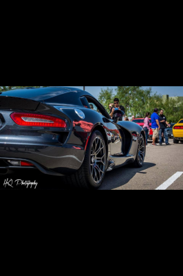

It's in my sig - 2013 Gen 5,about 13,500 miles now. Fantastic car to drive.
Your telling me..... it’s an instant head turner. I even caused a small fender bender with 2 other cars cause they were distracted with my Viper. When I’m driving it I always fear that some douch bag is gonna want to record my car and not be paying attention and accidentally run into me. Maybe I’m just paranoid. Anyway hope you figure the truck leak out
Here’s my baby 2015
