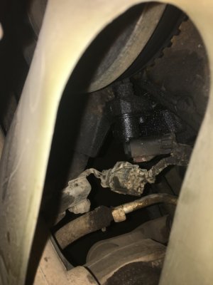

Good morning! I thought I had an oil pan gasket leak but upon inspection I think it is coming from something in the front left(drivers side). Is this the oil pressure sensor or something else? And is it an easy fix?
Thanks so much!!

From the picture it appears that we are looking at the crankshaft position sensor on a Cummins. Is that correct?

It is a Cummins. I don't know what it is but it is leaking oil. I'll search to see if it is a crankshaft position sensor. Thanks

Wouldn't be coming from the sensor, that reads the tone wheel on the dampener and doesn't go through anything with oil. What's that behind it?

The oil that is on the crankshaft position sensor could be coming from the front crank seal in the timing cover or possibly from the oil pan gasket. I would clean the oil off with a rag and some brake cleaner and monitor the situation.
