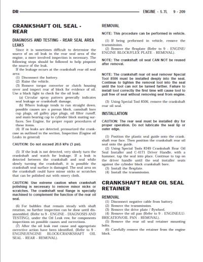

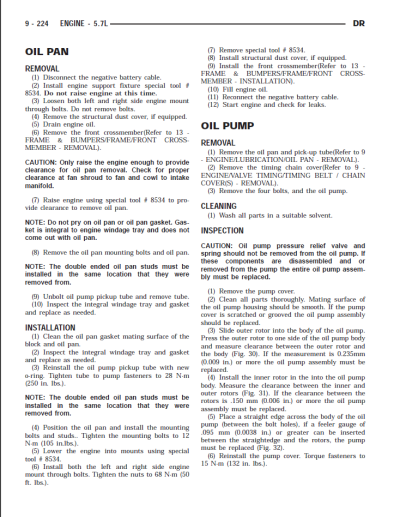

Here are a couple of pages out of the factory manual to hopefully help.
