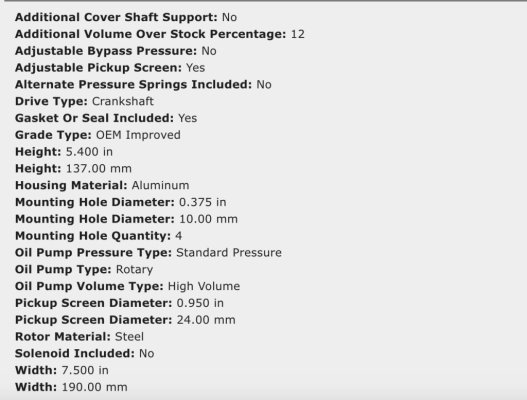

That is not the pump I used. The part number was M452HV, not 10452HV. The instruction sheet that came with the pump clearly stated is was standard pressure and alternate WHITE spring was increased pressure.
Oh well, I am not taking it apart again and I do want to run 5W-30, so I am going to adjust the voltage going to the ECM by 12% as this pump is 12% higher in volume. As long as I get it into a range that satisfies the ECM it shouldn't be an issue. Even the information listed below from the Melling website is wrong as it does not mention the white spring.Pump Info.jpg

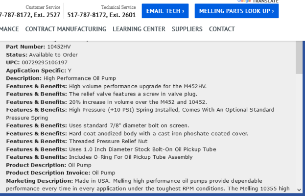

Oh well, I am not taking it apart again and I do want to run 5W-30, so I am going to adjust the voltage going to the ECM by 12% as this pump is 12% higher in volume. As long as I get it into a range that satisfies the ECM it shouldn't be an issue. Even the information listed below from the Melling website is wrong as it does not mention the white spring.View attachment 551945
By the sounds of this video that pump is a stock replacement pump for the Hellcat,so it'll have a high pressure spring in it right from word go,and the White spring would up the pressure for a Hellcat,and would blow the pressure through the roof if you used the optional White spring on a 5.7. How did you end up picking that pump instead of the 10452 pump which is the pump most guys are using with the lower pressure spring. In your case,you probably should have reused your original bypass spring from your stock pump.
Supposedly guys have had decent luck using the Hellcat oil pressure sender to combat the oil pressure code,that'd be easier then trying to reduce the voltage using resistors as Sky/Reignited suggests
