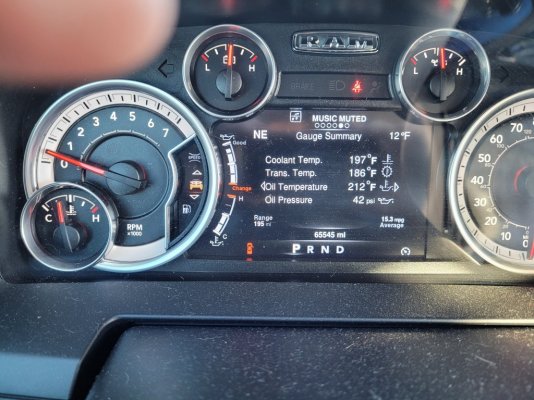

Idle is stock, as stated no mods on this truck. Oil temp is 213 to 215. Has stock 203 thermostat for engine coolant. Coolant temp is 203. Trans temp is 185.
It has fresh redline 5w30 less than 1500 miles ago with a rp 20 820 filter.
The concern for me is this truck at warm idle no matter temp, speed or miles traveled has never had a warm idle oil psi less. Than 48. Now it's suddenly 41, cut it off restart it. It jumps back to 48.
It mimics a bad sending unit for oil psi. Just not willing to change it out if I'm not sure. Mechanically the truck is running perfectly

Answers to your questions
Cold Idle 1000. 55 to 58
warm idle 550 rpm 48
1800 to 2k rpm. 53
Warm idle 550, oil temp 213 , after 2 hour drive 41
Warm start 48
I'll take more specific readings on Saturday, course it will be 30 degrees

If you remember put that gauge on after a long drive, for sure something is a miss if two warm rpm's 550 are showing different psi by 7. Could be gauge or maybe that sensor, or something else we are missing.

@Burla, here are drive back photos, warmer the outside temp, higher the pressure.
Manual gauge review tomorrow when the world reopens
