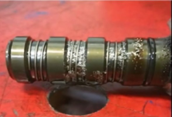

Most of the ones that have worn to the point of misfire, the VVT solenoid screen is loaded with shavings. Mine had 20 - 30 or so. That's why I'm opting to fix mine.
Here's a pic of a loaded one from the net. Some are worse than this.

Thank you for the pictures as that will definitely help. I cut my oil filter open yesterday after my oil change Saturday and I found 0 metal in it. I pulled a lot of the filter media apart.
I would imagine it doesnt take long for the roller to eat the cam to the point of a misfire once the needles lock up.
The metal in my filter was really fine, and down in the pleats.
Great that you didn't find metal in your filter, here's to your VVT solenoid being clean as well.

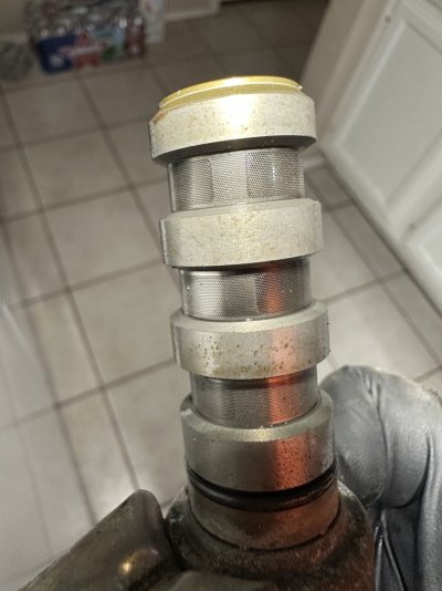

Got my intake manifold loose enough to get the VVT solenoid out. Looks pretty clean but obviously some specs on it. Don’t see much compared to a lot of what I’ve seen on bad solenoids.
The attached picture does look like a relatively large amount of metal shavings specifically in that area.
Thoughts?

Damn, that's a good bit less than what was on mine.
Looks like they changed the valve a little, too.
