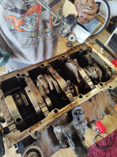

If I had known it was a reman I would have recommended you remove the oil pan from the beginning and toss in a set of rod and main bearings and go on about your business.
Damn, well I appreciate the heads up. I just glanced over it without doing any of that. Kind of assumed they would be fine since it had such low mileage on it and it turned over nice and smooth. I know they have super tight tolerance though, probably should have done a bit more research on what to look for first. Once I get back I'll do the pressure test and keep my fingers crossed.

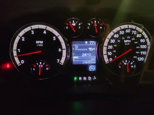

So I recently replaced my MDS lifters with non-MDS, replaced the oil pump with melling high volume oil pump, and installed an MMX NSR NTR camshaft. I also switched to a slighty thicker M1 5w-30 oil.
(MDS delete purchased through moes performance.)
Cold start: 80+ psi
Driving operating temp: 65+ psi
Idle operating temp: ~24 psi
I feel like the idle pressure is way low considering the pump. I know the truck idles pretty damn low as it is, but without being able to adjust the idle at all I am worried that I could run into the same lifter issue down the road. Any ideas? Thanks

My 2011 has the MDS delete, same cam, same oil pump ( high pressure spring in ) After the engine rebuild my idle pressure at stock rpm was, I think, 27. I upped the idle to 750 and its 37psi. Cold start psi is also 80. I also run 5-30 oil. I have not verified the psi with a mechanical gauge. My motor runs good, ( HF 87 tune ) but I have been fighting with trying to find a "pump" whine sound since it was rebuilt. I feel like it could be the oil pump or trans pump. It sounds like a power steering pump, but the noise persists with the belt off. Also the noise is louder cold and quieter but still present at operating temp. 4000 kms on the rebuilt motor, engine oil samples return normal.
Fast69, do you see those hot idle pressures at the factory rpm?

I see a lot of 5.7 HEMI's on a weekly basis and I am always looking at what the EVIC says for oil pressure. 27psi is a touch low for your hot idle compared to what I see in other motors coming through the shop. I see 30-32psi oil pressure at hot idle with the stock idle RPM on most. Yours is not far off. I have found in my own inspections and diagnostics on 5 or 6 5.7 Eagle motors that had hot idle oil pressure below 30psi there was some excessive clearance on the rod bearings and the largest discrepancy I found on these motors was about 0.0031" and the other journals were within 0.0017".
Just a quick guess on your pump whine sound would be the trans pump. I have been around the RFE since it's inception in the 1999 WJ and that pump can easily be mistaken for a whining power steering pump.

When the motor was assembled do you know if the bearing clearances were checked with Plastigage or were the journals mike'd with a proper digital/manual caliper?
The reason I ask is because Plastigage is not always the most accurate measuring tool.
