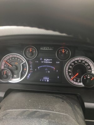

D5447438-0C4C-409D-9C0D-FD2451ACE0E1.jpeg I’m having an issue with my 2015 Ram 1500 3.6L
The oil temp gauge(s) will cut out while driving usually about 30 to 40 miles into a trip. When this happens if I give it enough throttle to hit around 4000 rpm the engine cuts out as if the govener kicked in. I have to get off the gas until it drops down to about 2000rpm before I can apply throttle again.
It creates a dangerous situation at times.
When I turn it off and let it sit for a few minutes it will reset.
The dealer has looked at it multiple times and can only guess at the fix. Last time they replaced the oil temp sensor and wiring harness. That seemed to fix it but less than 10000 miles since the repair and it’s doing it again. The truck has 91,000 miles on it no warranty. Any ideas would be greatly appreciated.
