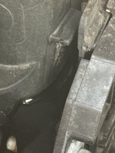

Yesterday evening, was telling my nephew about fixing my high temp issue. He said he noticed his '18 Laramie with 140k miles running near 230°, and just yesterday noticed a stain on the drivers side of the curb stop where he was parked. When he checked his coolant level, it was down a bit. He had some pint bottles of water, and he said he added about 3 bottles worth to top off the radiator.
I said that was about how much I added when my radiator went south, and to check his radiator below the upper rad hose for wetness or staining. He sent me this pic:
Bingo! He is the next winner of Your-Radiator-Just-Shat-The-Bed Lottery....lol.
That makes 10 or so failures that I know of since mine died last year, that had leaks in the same area.
Wild
He has not changed his coolant, so you all know how my weekend will be.
Moral of the story:
Keep an eye on your temps, and if you see coolant temps in the 220° to 230° range, and you're not exercising the skinny pedal, or towing heavy, or running up grades, etc., check your coolant levels and components for problems.
Also, keep some basic tools and supplies on hand, just in case. Me having that gutless thermostat gave me the ability to not overpay at the parts store for a poor-quality replacement t-stat. I was able to wait for the one I wanted, and bought an extra.
Wild
Moral of the story:
