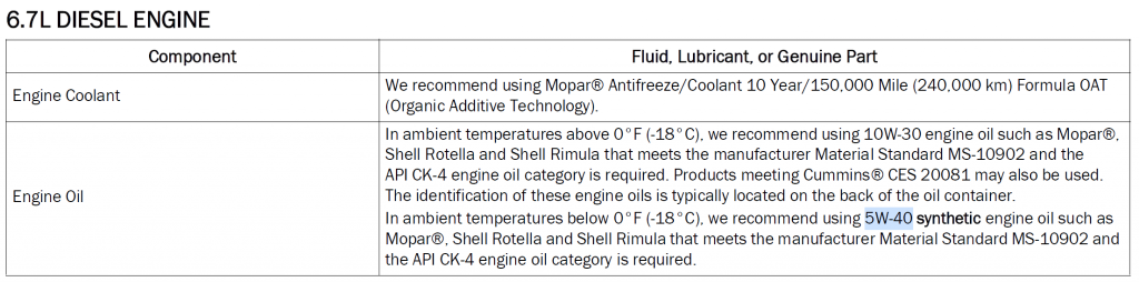

I was told that info at the dealer, when I took it in to fix the trans recall. The owners manual calls for 10w-30 with temps down to zero then it calls for 5w-40 for temps below zero. I will stick with 5w-40. Sure do miss my 2013 2500.

You do realize that both 5W-40 and 10W-30 are recommended weights for the 6.7 engine depending on the ambient temperature range. What doesn't make sense is the fact that it's the 5W-40 recommended for colder weather which is what the OP has moved into vs the hotter weather of the south.
