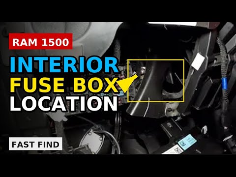

Want to remove lower dash trim to make the front usb outlet a constant 12v.
Looked a a lot of threads, but if there is an easy way to do, not removing the entire front dash???
Seems like the area with lower drawer may just snap out, but since I never worked on this brand, not sure if you just pull and hope or is there a couple screws, bolts to remove first?
Thanx for any help, and my truck has about as many miles on it as I do!! Basic truck no frills

Interior fuse box, under dash, near steering column. That lower plate snaps out, also 2 screws. On MY 19, I think the fuse is 54A, but do not get me lying. Just be nice and gentle on them there tabs. It is a fuse that is in a 3 prong socket, can go either way ref making 12V constant on battery as opposed to key.

Thanx to all. I found easy solution, can add 12v at lower panel. All good
