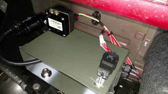

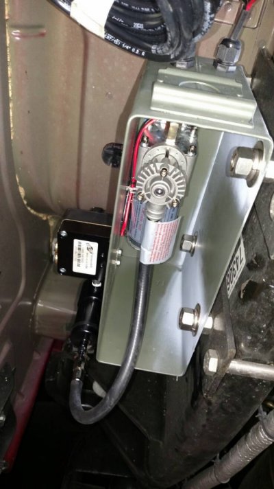

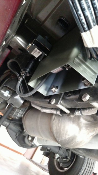

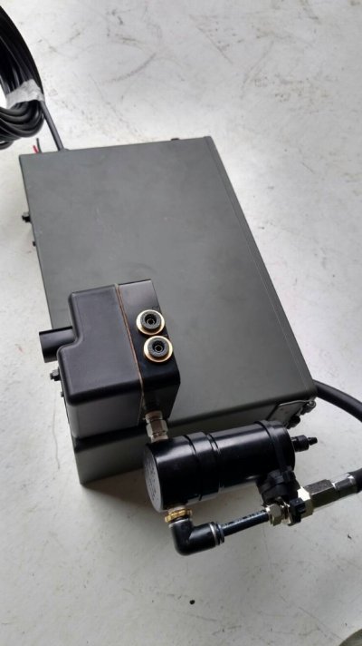

I installed a compressor for my air bags. I didn't do a tank as it was not really what I need. Here are some pics of how I installed the compressor.
I used an ammo can. I inverted it and left the lid off.
I mounted the compressor inside the can and the regulator on the exterior, along with the electrical components.
I fabbed up some brackets using 1/4" steel plate and some 1/2" bolts (you have to take care with bolts this big as you can crush/distort the frame of you over torque them.) I countersunk holes on the frame side of the brackets that the cab attaches to. Then installed 4 (qty) 1/2" flat head machine bolts to mount the can with.
The pics are a little out of sequence. I installed the air ride 5000 bags and the air ride compressor with wireless control. I installed this last summer. I did the can upside down and open to allow air circulation, and to not allow moisture to accumulate inside. The can provides really good protection from the environment and makes an excellent platform to mount all the parts to.
I just was under the truck changing the oil and fuel filters last weekend and I was really surprised to see that the compressor is clean. Especially after daily driving in snow, ice, rain, and mud ask winter.
I'm very pleased with how I this looks and functions. I think most onboard air compressors would fit in the ammo can I used. But you could easily use a little bigger ammo can if you wanted.

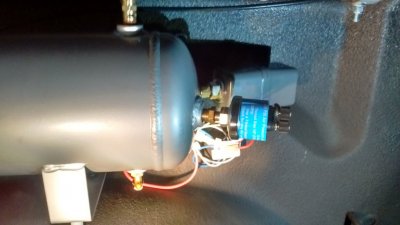

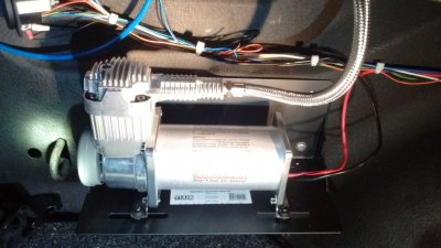

Here is my VIAIR onboard air system install. I worked with Steven Smith at Timber Grove for the pressure gauge. He told me that I would prefer the digital gauge instead of the dual needle analog gauge. He was right! The top pressure is the tank and the bottom pressure is the ASAM springs.
