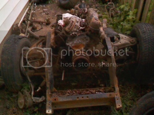

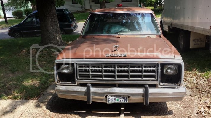

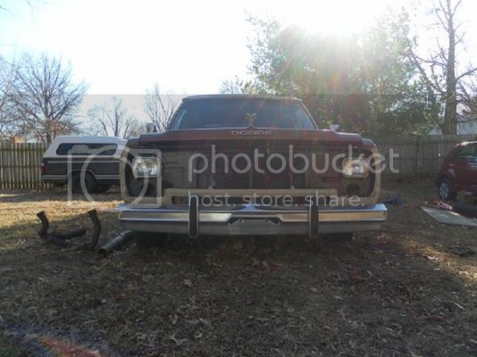

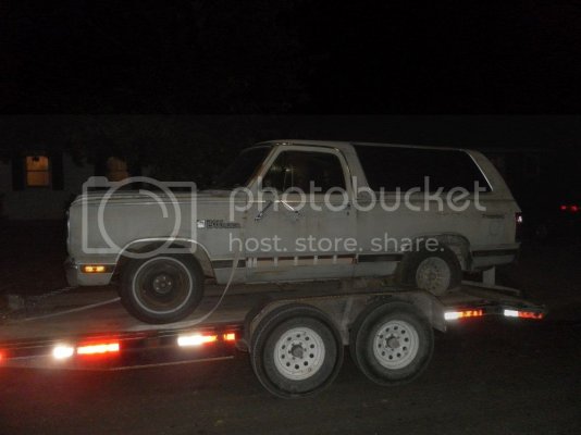

About year & a half ago I bought this nearly complete 84 2WD RC Prospector II
I bought it for the rolling frame,gas tank,etc & the 4 1/2" pattern turbine wheels
The firewall & floor pan is going in my CrewCab with buckets & consoles front & rear

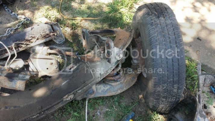

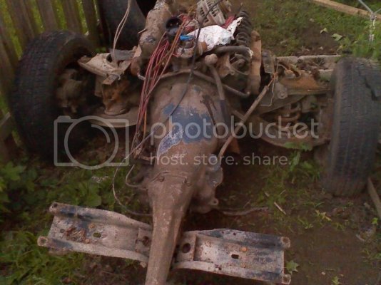

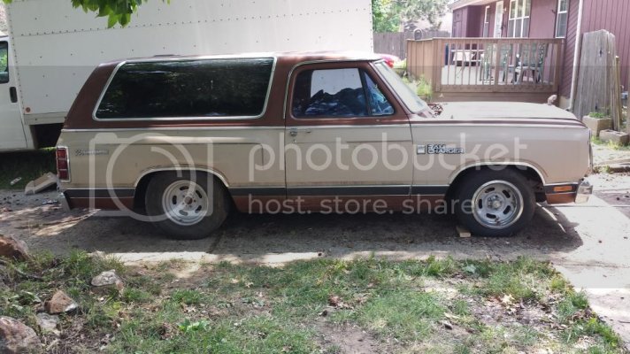

A day or two after the above picture it looked like this

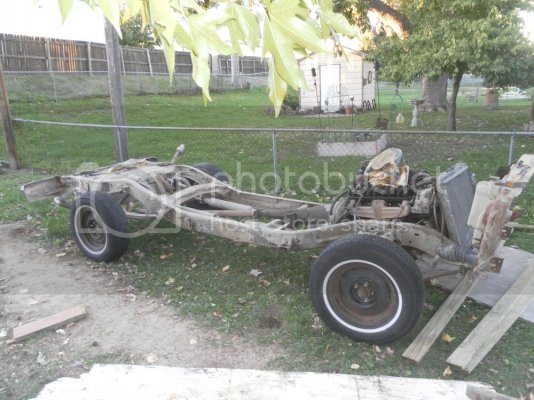

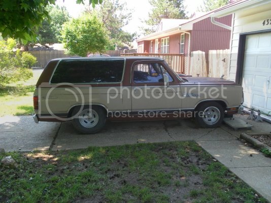

Then winter came & spring left & two weeks ago it looked like this after working a little on it a little
My goal is to take the crossmember from this frame & melt it together with the frame of my RC in my sig & gain another 2 3/4" of drop in the front

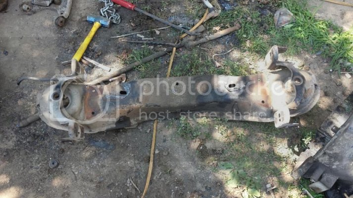

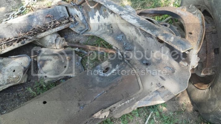

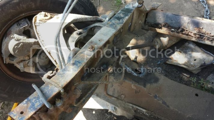

Separating the crossmember from the frame rails took some flamewrenching & hammering

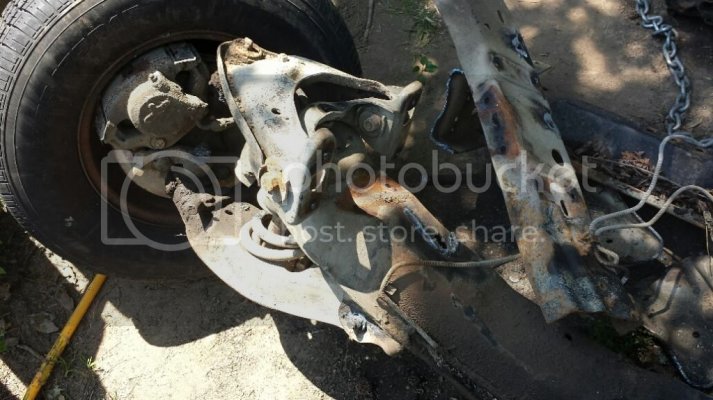

Now it's ready for grinding & pressure washing

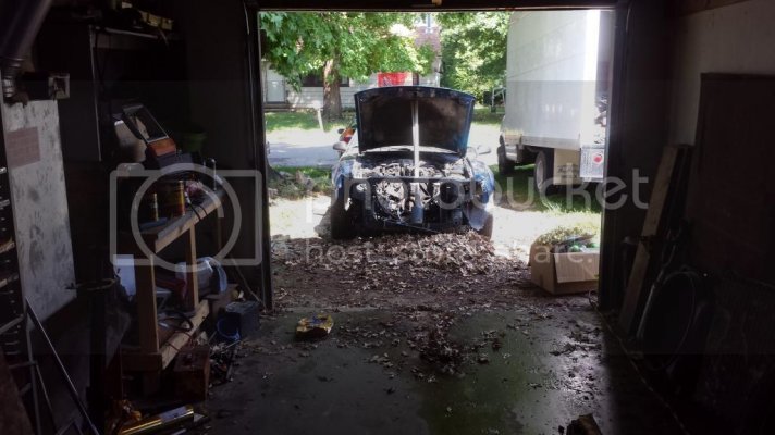

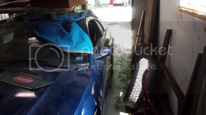

Today I unpiled & uncovered the Mustang GT living in my garage to make room for the work I'm doing to my RamCharger & what this thread is aboutWorkPhone219_zpsfa8997ec.jpg

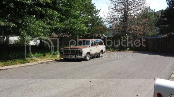

Here's my RamCharger backed out into my street awaiting me to remove the engine,trans & front suspension
