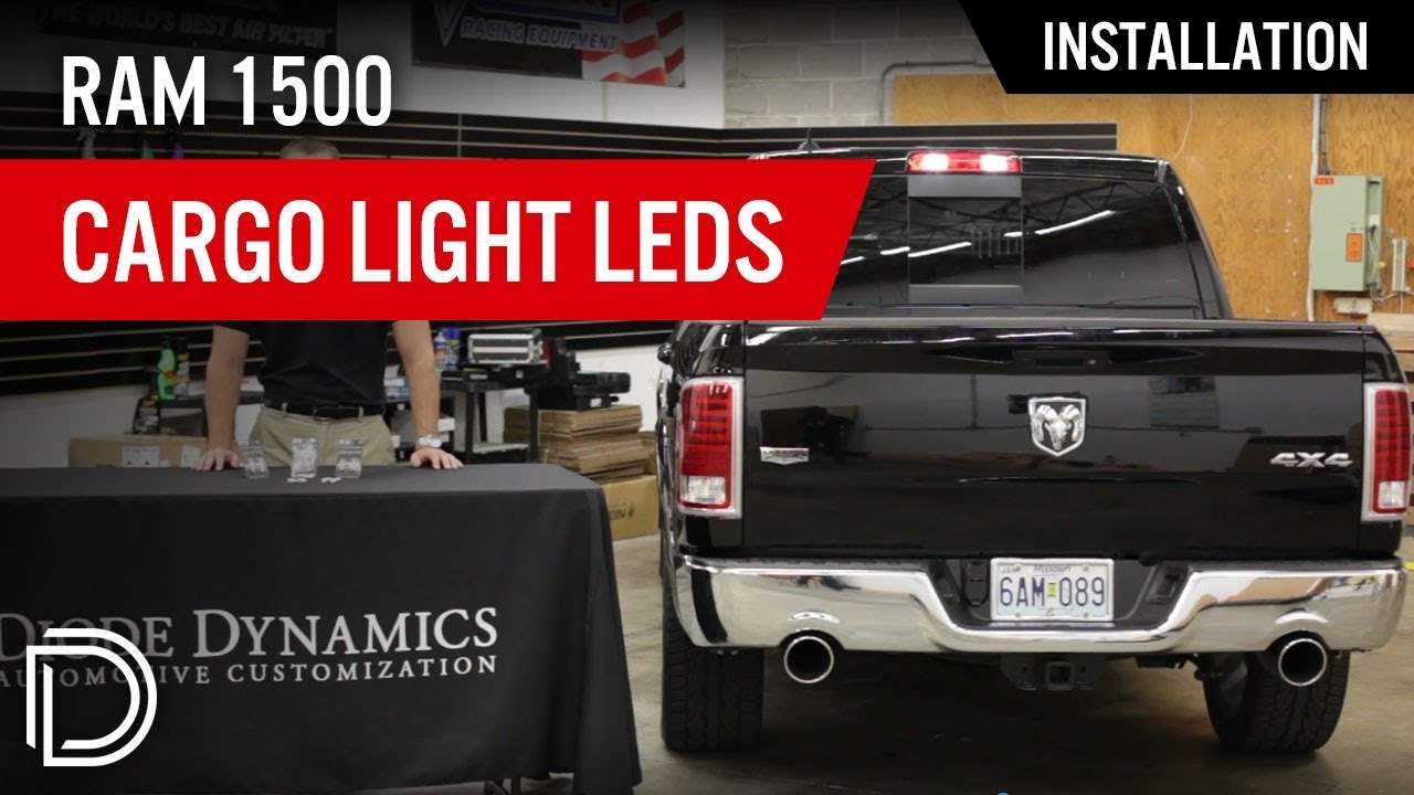

Are you not the original owner?
For the amount of time required to learn about the gasket and whether it's incandescent or LED, it might be worth the effort for a quick removal.
If the third brake light looks like the one in this video, you could be lucky. I changed the incandescent cargo light bulbs in mine to LED at a very low cost, using bulbs from Amazon.
If the CHMSL on your truck is an OEM LED type, I would expect it to be a sealed unit with no access to the bulbs.
